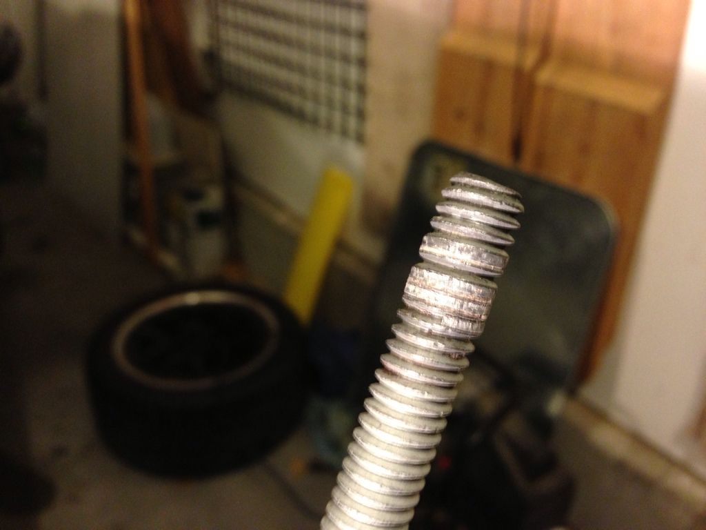

My buddy and I were finishing up the installation of the heads. We were on the second head and the installation was going fine until we got to the final bolt. The tort procedure is in three stages. The number 9 bolt is the bolt in question. First we torqued the bolt to 22 foot-pounds then we useed our torque degree wheel to torque a further 90° and then finally torqued to 50°.
When we got to the last 50° of torque that's when my buddy noticed the tension on the wrench wasn't right. Sure enough we stripped out the head bolt.
I'm hoping there's someone out there that has purchased the GM thread restorer kit and would be willing to loan it to me so I can fix my block and finish the job.

A helicoil is the only way to repair the block. A word of advice, throw those torque to yield head bolts as far as you can and install ARP studs. Install the heads and torque the nuts as you would an old style head bolt.
Upon giving this some thought, I think you might have had some fluid in that bolt hole.

A helicoil comes in the kit. Usually several. I'm hoping someone has the kit and extre helicoils.
I blew out the thread hole with compressed air with a long straw type tube from the bottom to the top. It was clear. The block threads just let go. It happens, unfortunately.

That bolt looks dry. Did you use any oil or other type of lubricant when you were torquing them down? You need to use something as the stiction is really strong when you don't. The lubricant gives you accurate torque readings.
The manual didn't call for any type of lube.

I found a Time-Sert kit on eBay for $175 shipped. Thanks anyway.

The damage may have already been there from the previous owner.
As far as the lube goes. Many use regular engine oil but I used a product specific to head bolts. If memory serves me right, it's made by ARP.
That sounds like a good theory, let's go with that. Everything else was caused by the donkey I bought the car from.

Sending you a pm on the importance of lubrication while torquing. Check it out.
