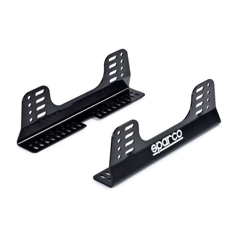

The Speedware bracket looks like the Sparco brackets...
Speedware...
Sparco...
http://www.ogracing.com/eshop/images...00490W_web.jpg
If those are all I need, I'll just go to OG Racing in NoVA and pick them up.

The brackets you have shown are side mounts. You need the bracket that Speedware and various other companies fabricate in-house that bolts to the floor in the stock seat mount locations. Those fancy blue alum. things are to turn the Speedware bracket (called a bottom mount) into a side mount application.
