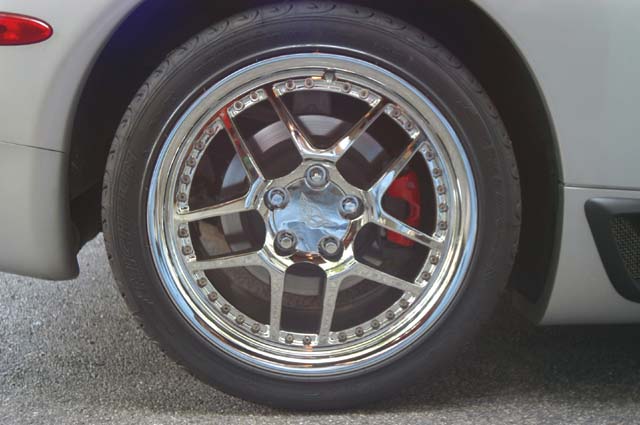

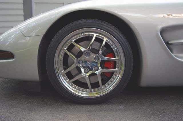

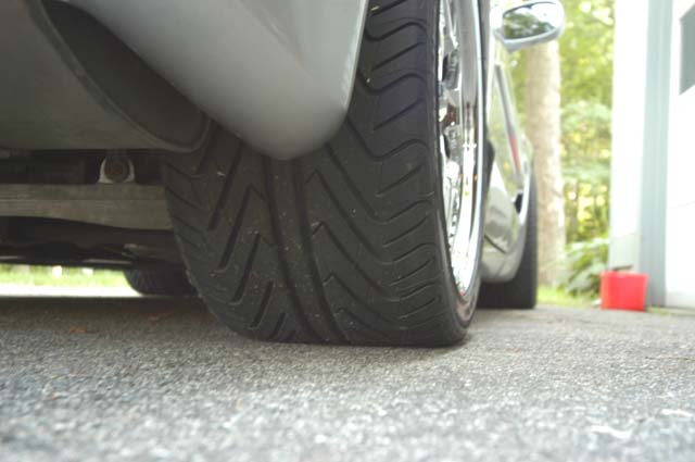

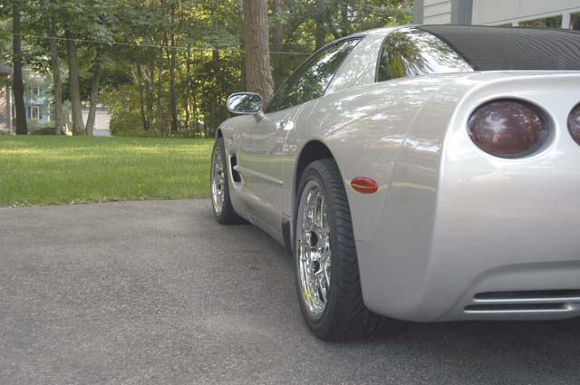

I'm pleased to report that everything fits fine. Clearances both up front and in back are close, but I have not been able to get anything to rub, even on hard corners and/or bumps, even with with a passenger in the car. The suspension on my car *was* lowered the factory-bolt maximum-amount a few months ago.
The Tire Pressure Monitor works great, exactly like it did on my 98 Coupe. There's quite a lot to be said for being able to check each tire's pressure whenever you want, from inside the car, even while driving down the highway! You may not know what you're missing if you've never had it, but of all the "convenience feature" differences between my 98 Coupe and the Z06, I missed this most of all.
The Michelin tires, mounted on the Motorsport rims, are noticably heavier than the F1s on the OEM wheels. Some of this is the increased rubber, but I suspect most of it is the repro wheel. I did not measure the difference, but I don't expect to drive in a way that it could matter much, anyway. Just an observation, the OEM wheels are pretty light weight.
The best news is that the Pilots look *great* on the car, have *tons* more grip than my F1s did (they were pretty worn out, though, that last 1000 or so miles), and are substantially quieter on the highway.
