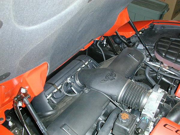

Stock setup

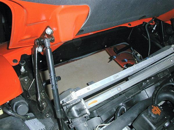

Removed stock box
Put the front of the car on ramps. I do not drive onto the ramps. I lift the front and slide the ramps under the tires.

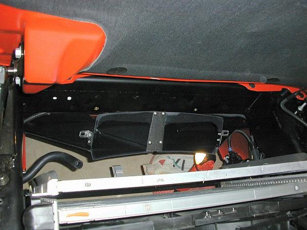

Removed shroud
Reversed the bottom clips holding the Z06 screens. I painted the top of the clips black so they can’t be seen through the front of the grills.
Ram tubes

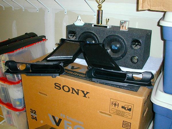

Installed the scoops to the bumper. I shimmed them to fit my car, 5 up top, 3 on the bottom. I also put extra washers under the bolt heads to protect my bumper. This pulls the bolts away from the front of the bumper.
Scoops come up under the hood.

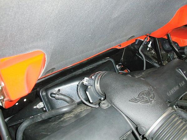

Finished system. I replaced the supplied 4mm Allen head airbox bolts with heavy-duty ¼” x 1 ¾” hex head bolts from Home Depot.

>>Do you need to take the radiator shroud out?
Yes, and the instructions that come with the VaraRam do not mention the two white plastic stud-clips that hold the shroud to the AC Condensor. I popped the clips off the condensor, removed the metal rings holding them to the shroud, and then twisted the clips back onto the condensor.
This picture shows one of the clips, with the metal ring removed.
>And when do you put it back in?
After you mount and shim the scoops to the bumper. Make sure you hook the top end of the shroud under the lip of the plastic radiator top crossover support.
