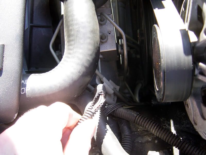

Problem is, the wires still look like they should conduct, though the wire protection is gone. Why am I still getting the error? Any ideas?
1,279 Posts
What codes do you have..Here is how to check them..http://www.zo6vette.com/ipc.txt ..By the way if that wire is not chaffed or touching the other one,there is nothing wrong with it..That is just the loom that came off. :usa:
518 Posts
Discussion Starter · #4 ·
Well, the loom was worn off and the wires are chafed but not totally worn through. No real way to know if they touched or not.
I have the C1214 HC code, and my own copy of the service manual. Looks to me like I'll need to have the EBCM and BPMV replaced.

I got this exact code the other day while driving. Pulled in and shut the car off at my destination, cleared the code, and restarted the car. Haven't had the code again. Really wierd. I'll check my loom though, thanks for the pic.
